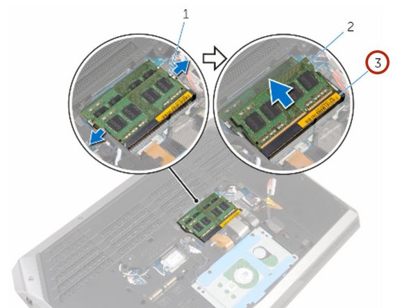

In this guide, we will show you how to remove and replace the Memory Modules.

    1. Dell Alienware 15 R2 Memory Modules Replacement, Popping up the Memory Module: step 1, image 1 of 2 Dell Alienware 15 R2 Memory Modules Replacement, Popping up the Memory Module: step 1, image 2 of 2
      • WARNING: Before working inside your computer, read the safety information that shipped with your computer and Before Working Inside Your Computer. After working inside your computer, follow the instructions in After Working Inside Your Computer.
      • Using your fingertips, carefully spread apart the securing clips on each end of the memory-module slot until the memory module pops up.
