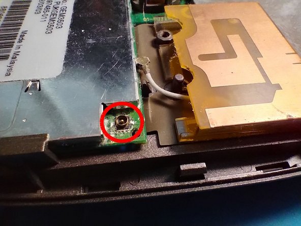

    2. Danger Hiptop Battery Replacement, Disconnecting the antenna connector (Canada Fido model only): step 2, image 1 of 3 Danger Hiptop Battery Replacement, Disconnecting the antenna connector (Canada Fido model only): step 2, image 2 of 3 Danger Hiptop Battery Replacement, Disconnecting the antenna connector (Canada Fido model only): step 2, image 3 of 3
      • Skip this step if you have the U.S. T-Mobile model.
      • Locate the antenna connector. With a spludger, gently pry up under the connector where indicated, and it will pop off.
