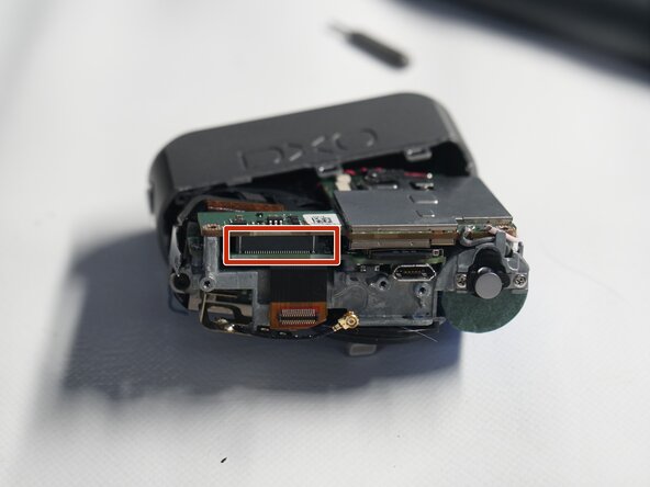

    5. DXO ONE Lens Assembly Replacement: step 5, image 1 of 3 DXO ONE Lens Assembly Replacement: step 5, image 2 of 3 DXO ONE Lens Assembly Replacement: step 5, image 3 of 3
      • Use tweezers to pull the ribbon cable out of the clip.
      • Remove the two 3mm screws located on the circuit board.
      • Insert the plastic pry bar into the gap shown in the picture to separate the circuit board from the clip below.
      • Please note that there is a WiFi antenna connection cable between the circuit board and the clip; please be careful when separating the clip.

    6. DXO ONE Lens Assembly Replacement, Remove the screen: step 6, image 1 of 3 DXO ONE Lens Assembly Replacement, Remove the screen: step 6, image 2 of 3 DXO ONE Lens Assembly Replacement, Remove the screen: step 6, image 3 of 3
      • Use a plastic pry bar to pry open the clips on the black ribbon cable.
      • Use tweezers to remove the black ribbon cable.
      • Remove the OLED screen

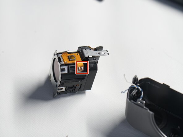

    1. DXO ONE Lens Assembly Replacement, Remove the silver housing: step 7, image 1 of 3 DXO ONE Lens Assembly Replacement, Remove the silver housing: step 7, image 2 of 3 DXO ONE Lens Assembly Replacement, Remove the silver housing: step 7, image 3 of 3
      • Following my previous guide, your device should be in this state now.
      • Remove the single 3 mm screw from the top.
      • Gently wiggle and pull the silver housing outward.
      • There is a switch on the silver housing connected to the device's lens cover; please do not pull forcefully to avoid breaking the wires.

    5. DXO ONE Lens Assembly Replacement, Completely remove the lens assembly: step 11, image 1 of 2 DXO ONE Lens Assembly Replacement, Completely remove the lens assembly: step 11, image 2 of 2
      • Use a soldering iron to disconnect the silver housing from the lens assembly.
      • Congratulations, you're done!
      • When using this guide as a prerequisite (i.e., if you do not want to replace the lens assembly, but are continuing to replace other components and preparing to follow subsequent guides), do not disconnect the lens assembly from the silver housing; instead, carefully set them aside.
