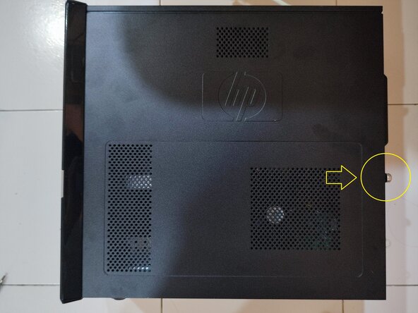

    1. DVD Drive Removal, Remove the side panel: step 1, image 1 of 2 DVD Drive Removal, Remove the side panel: step 1, image 2 of 2
      • Use a screwdriver or your hands to unscrew the screws.

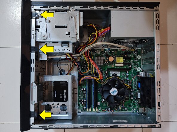

    2. DVD Drive Removal, Remove the front panel: step 2, image 1 of 2 DVD Drive Removal, Remove the front panel: step 2, image 2 of 2
      • Unhook the three clips to complete the removal of the front panel.
      • It is recommended to stand the computer upright, as this will make the removal easier.

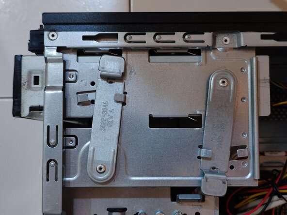

    3. DVD Drive Removal, Release the DVD drive locking clip: step 3, image 1 of 2 DVD Drive Removal, Release the DVD drive locking clip: step 3, image 2 of 2
      • Pull the clip up slightly.
      • Then push it in the direction of the arrow until it appears as shown in Figure 2.
      Ask FixBot
    4. DVD Drive Removal: step 4, image 1 of 1
      • Push the DVD drive in the direction of the arrow from the back to perform its removal.
