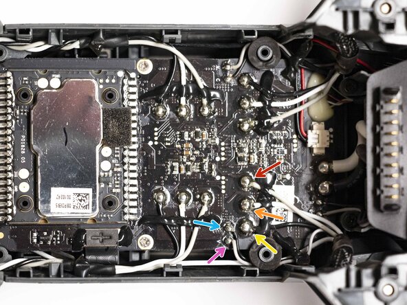

    6. DJI Mavic Pro Front Arm Assembly Replacement, Desolder the arm wires: step 6, image 1 of 1
      • Desolder the larger gray motor wire running to the arm to be replaced
      • Desolder the larger white motor wire
      • Desolder the larger black motor wire
      • Desolder the smaller black LED wire
      • Desolder the smaller white LED wire
      • The marked wires are for the right arm. The wires to desolder when replacing the left arm are the mirror image of the ones shown here.
      • Don't forget that plastic has a tendency to melt when exposed to heat! I may or may not have disregarded this fact and put a mark on my drone...
