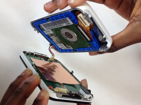

    5. Creative Zen Vision M how to open device: step 5, image 1 of 2 Creative Zen Vision M how to open device: step 5, image 2 of 2
      • To remove and separate the screen from the back of the device:
      • Use a flat edged tool to pry around the edge of your device. Place your flat edged tool between the edges around the screen. Gently lift up and your screen will separate from the top half.
      • The bottom half will still be connected by 3 wires to the top half, so do not disconnect (yet) or break the wires.
