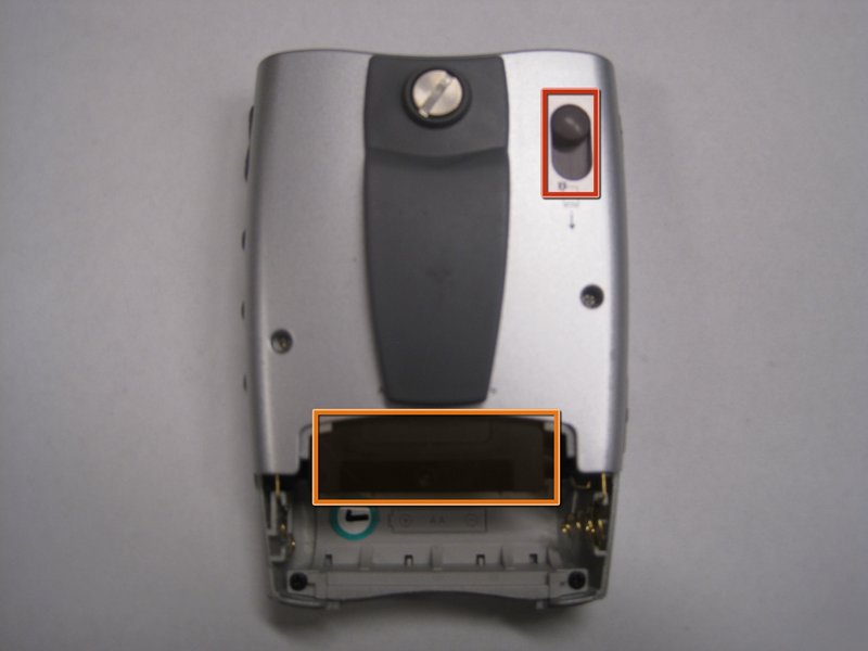

    1. Creative Nomad II SmartMedia Card Replacement, Smart Media Card: step 3, image 1 of 1
      • Slide down the eject button.
      • Pull out the old SmartMedia Card.
      • Insert the new SmartMedia Card.
      • The notched corner of the SmartMedia card should go in the top left corner.
