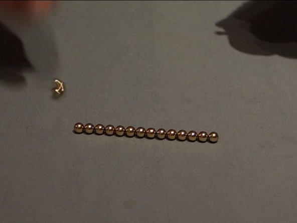

    2. Creating a chain bracelet, Pull out the first partial chain: step 2, image 1 of 3 Creating a chain bracelet, Pull out the first partial chain: step 2, image 2 of 3 Creating a chain bracelet, Pull out the first partial chain: step 2, image 3 of 3
      • Pull a first partial chain out of the lump
      Ask FixBot
      • Remove the first partial chain
      Ask FixBot

    3. Creating a chain bracelet, Remove the first sub-chain: step 6, image 1 of 3 Creating a chain bracelet, Remove the first sub-chain: step 6, image 2 of 3 Creating a chain bracelet, Remove the first sub-chain: step 6, image 3 of 3
      • Place it on the table
      Ask FixBot

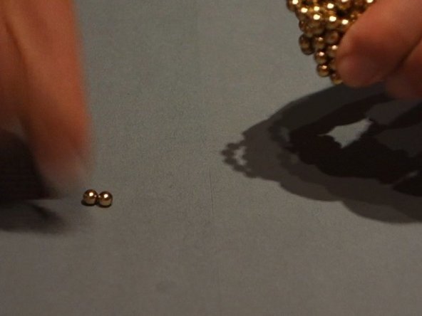

    4. Creating a chain bracelet, Pull out another segment of the chain: step 7, image 1 of 2 Creating a chain bracelet, Pull out another segment of the chain: step 7, image 2 of 2
      • Pull another segment of the chain out of the ball
      Ask FixBot

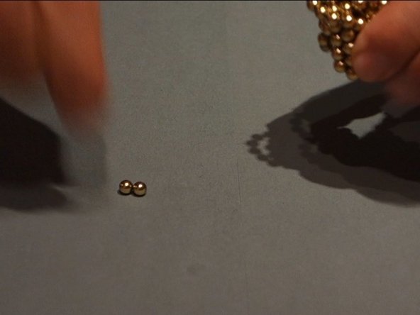

    5. Creating a chain bracelet, Throwing the chain segment onto the table: step 8, image 1 of 3 Creating a chain bracelet, Throwing the chain segment onto the table: step 8, image 2 of 3 Creating a chain bracelet, Throwing the chain segment onto the table: step 8, image 3 of 3
      • Throw the chain segment onto the table next to the chain.
      • The chain segment will automatically rotate to align with the chain on the table and connect to it.
      • Repeat this (starting from step 4) until all the beads from the tangle have been used.
      • If the chain accidentally connects to itself, it can be easily separated again.
      Ask FixBot

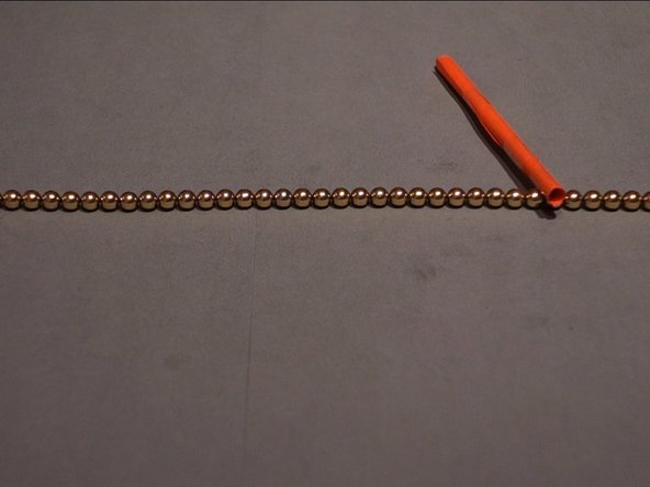

    1. Creating a chain bracelet, Count out spheres: step 11, image 1 of 3 Creating a chain bracelet, Count out spheres: step 11, image 2 of 3 Creating a chain bracelet, Count out spheres: step 11, image 3 of 3
      • Count out 36 spheres
      • Use a pointed rod, pen, or similar tool to count
      Ask FixBot

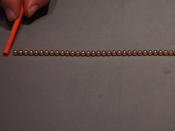

    2. Creating a chain bracelet, Fold the chain multiple times: step 12, image 1 of 3 Creating a chain bracelet, Fold the chain multiple times: step 12, image 2 of 3 Creating a chain bracelet, Fold the chain multiple times: step 12, image 3 of 3
      • Bend the chain behind the 36th bead.
      • Bead must meet bead! If bead meets gap, you cannot continue working and you must start all over from the beginning!
      • Repeat 4 more times until you get a 36x6 bracelet.
      • Alternate folding at the left end (marked in red) and ...
      • ... the right end (marked in orange).
      Ask FixBot
    3. Creating a chain bracelet, Result: Wristband: step 13, image 1 of 1
      • The result is a 36x6 wristband.
      Ask FixBot
