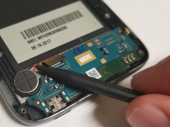

    2. Coolpad Defiant Daughterboard Replacement: step 5, image 1 of 3 Coolpad Defiant Daughterboard Replacement: step 5, image 2 of 3 Coolpad Defiant Daughterboard Replacement: step 5, image 3 of 3
      • Disconnect the metal cable using the plastic spudger.
      • The remove the glued down speaker from the backing.
      • Disconnect the little black wire from lower logic board.
      Ask FixBot
    3. Coolpad Defiant Daughterboard Replacement: step 6, image 1 of 1
      • Using the plastic spudger remove the lower logic board because the only thing that is holding it down is glue.
      Ask FixBot
