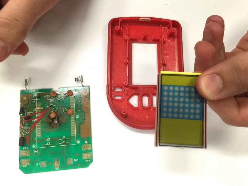

    3. Connect Four Electronic Handheld Screen Replacement, Replacing the Screen: step 6, image 1 of 1
      • Take the old screen out.
      • Replace the old screen with the new screen.
      • Ensure that the screen is facing right side up, where there is more yellow space under the checkered board.
      Ask FixBot
