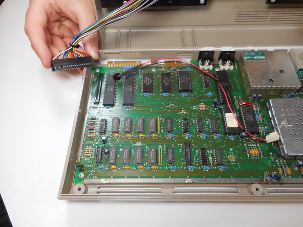

    5. Commodore 64 Removing the Shift-Lock Key, Removing the keyboard bundle cords from the motherboard: step 5, image 1 of 3 Commodore 64 Removing the Shift-Lock Key, Removing the keyboard bundle cords from the motherboard: step 5, image 2 of 3 Commodore 64 Removing the Shift-Lock Key, Removing the keyboard bundle cords from the motherboard: step 5, image 3 of 3
      • 5. Detach the multi-colored wire bundles connected to the motherboard
