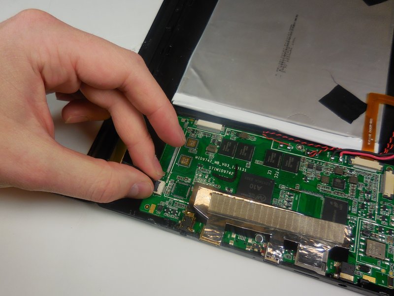

    1. Coby Kyros MID9742 Digitizer  Replacement, Digitizer: step 7, image 1 of 1
      • Gently pull on the black tab connecting the ribbon cable to the back of the tablet.
      • Remove ribbon cable from port to free the digitizer.
