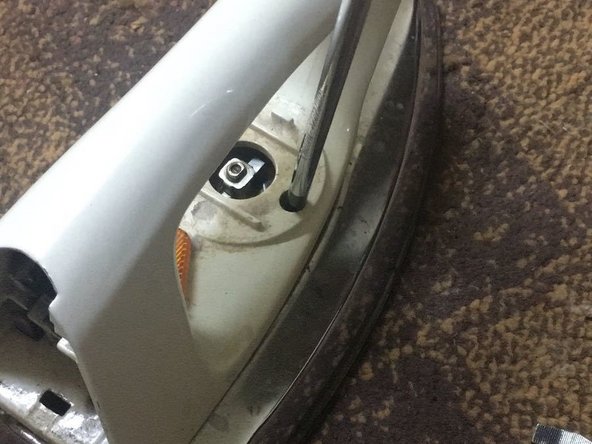

    3. Clothes Iron Heating Element Replacement: step 3, image 1 of 1
      • Use the screwdriver to remove the cover panel of the iron box
      Ask FixBot

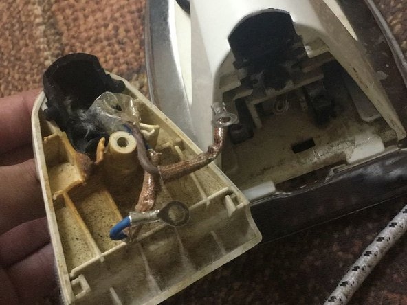

    4. Clothes Iron Heating Element Replacement: step 4, image 1 of 1
      • Check the power cord and the wiring inside the iron box and replace it with a new one if they are damaged.
      Ask FixBot

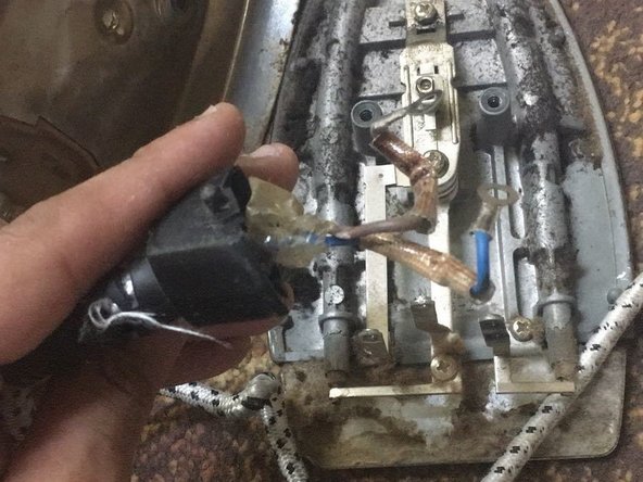

    5. Clothes Iron Heating Element Replacement: step 5, image 1 of 1
      • Remove the nuts that connects the wiring and the power cord inside the iron.
      Ask FixBot
    6. Clothes Iron Heating Element Replacement: step 6, image 1 of 1
      • . Rub off the stain with a soft cloth or a tooth brush if it got any to allow electric current to pass through.
      Ask FixBot
    7. Clothes Iron Heating Element Replacement: step 7, image 1 of 2 Clothes Iron Heating Element Replacement: step 7, image 2 of 2
      • Use the screwdriver to remove the screws holding the iron box thermostat.
      Ask FixBot
    8. Clothes Iron Heating Element Replacement: step 8, image 1 of 1
      • Replace the old thermostat with a new one.
      Ask FixBot

The backwards "RU" on the old thermostat means it is a UL tested device ('recognized'). You should replace it with a UL tested device.
john_banks_leonard - Reply Share
