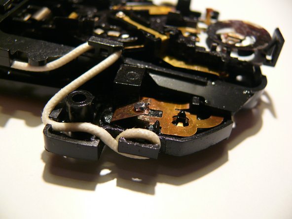

    3. Cloer Kettle Heating Element Replacement: step 3, image 1 of 1
      • Clean the damaged contact and apply a solder spot to the affected area. The photo shows what it looks like after the repair. You can then reassemble everything and it should work again.
      Ask FixBot
Follow the steps in reverse order to reassemble your device.
