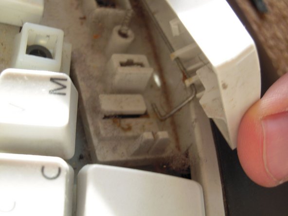

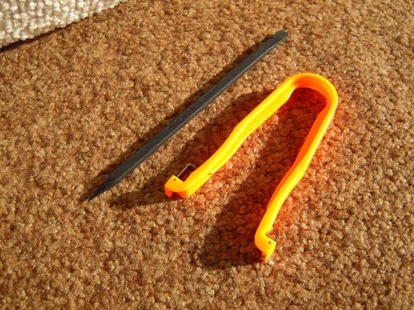

    • You will need a spudger to remove the keys. An IC mounting tool can be helpful in replacing them.
  2. Microsoft Natural Multimedia Keyboard disassembly and cleaning: step 2, image 1 of 3 Microsoft Natural Multimedia Keyboard disassembly and cleaning: step 2, image 2 of 3 Microsoft Natural Multimedia Keyboard disassembly and cleaning: step 2, image 3 of 3

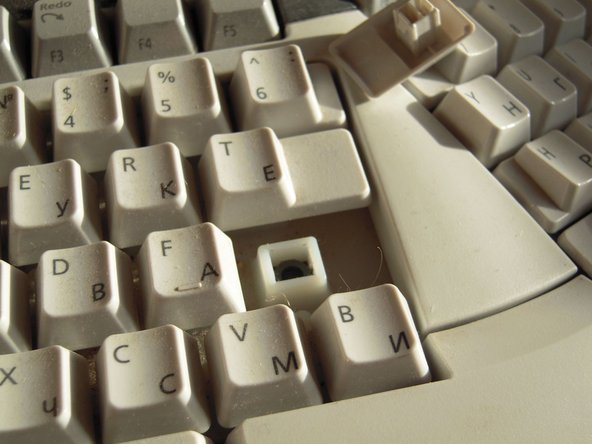

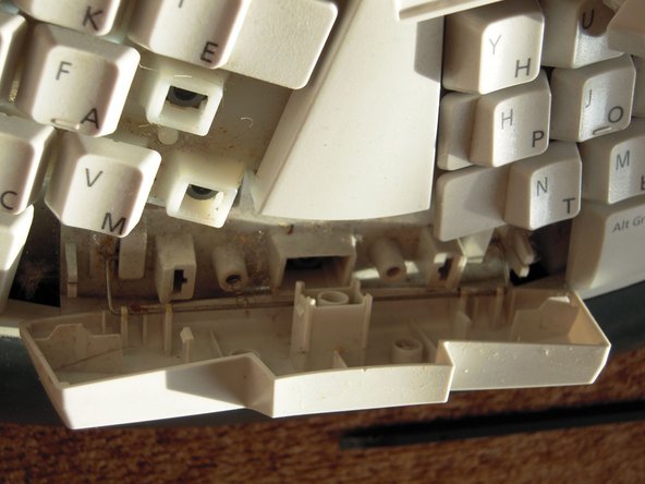

    • Use the flat end of a spudger to pop the keys off the keyboard.
  3. Microsoft Natural Multimedia Keyboard disassembly and cleaning: step 3, image 1 of 3 Microsoft Natural Multimedia Keyboard disassembly and cleaning: step 3, image 2 of 3 Microsoft Natural Multimedia Keyboard disassembly and cleaning: step 3, image 3 of 3
    • Wider keys will have a retaining bar, take note of how they come off to make reassembly easier.
    • Continue removing keys.

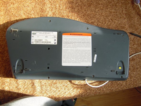

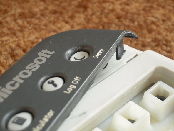

    • Remove the 10 screws from the bottom of the keyboard.
    • Remove the upper button assembly.

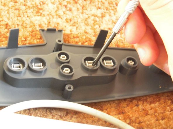

    • Use the tip of a spudger to push the upper button assembly buttons out from the back.

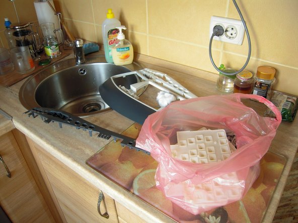

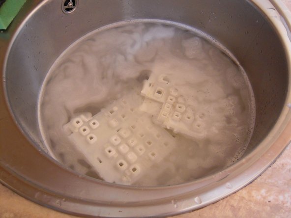

    • Remove the flexible keypad from the key caddy assembly.
    • The key caddies can be washed in the sink.

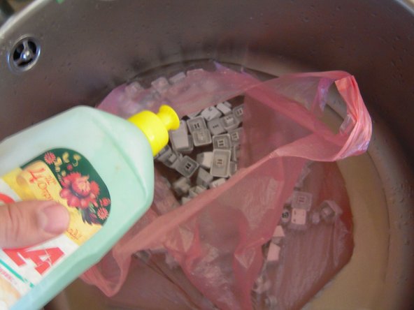

    • The keys can also be washed.
    • Remove the metal retaining clips before washing to prevent rust.
