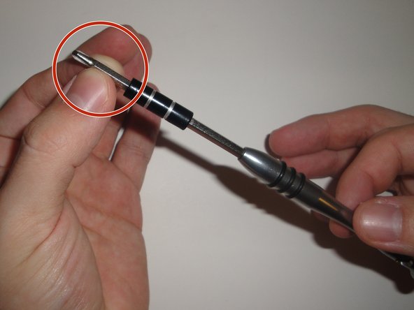

    2. Classique 087CQA Switches Replacement: step 2, image 1 of 2 Classique 087CQA Switches Replacement: step 2, image 2 of 2
      • Remove the Phillips PH0 bit
      • Insert the bit into the screwdriver
      Ask FixBot

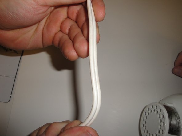

    12. Classique 087CQA Switches Replacement: step 12, image 1 of 3 Classique 087CQA Switches Replacement: step 12, image 2 of 3 Classique 087CQA Switches Replacement: step 12, image 3 of 3
      • Check power cord for tears or kinks
