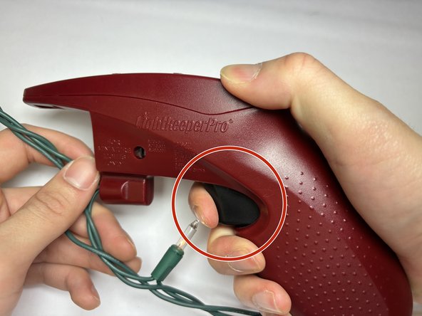

    • Plug in your lights at a power outlet.
  2. Christmas Lights Not Lighting Up Fix with Lightkeeper Pro: step 2, image 1 of 3 Christmas Lights Not Lighting Up Fix with Lightkeeper Pro: step 2, image 2 of 3 Christmas Lights Not Lighting Up Fix with Lightkeeper Pro: step 2, image 3 of 3
    • Press the button on the top side of the repair tool to activate the voltmeter.
    • Pressing this button will tell you if electricity is running through a section of your lights.
    • The repair tool will beep when it detects running electricity. If it is silent, then one of the bulbs on that specific wire is keeping the electricity from flowing.

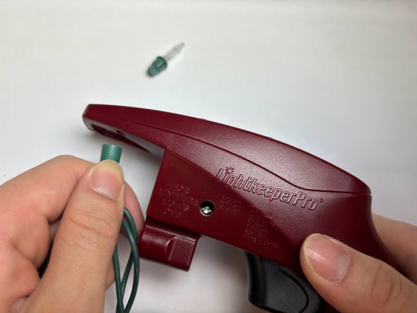

  3. Christmas Lights Not Lighting Up Fix with Lightkeeper Pro: step 3, image 1 of 3 Christmas Lights Not Lighting Up Fix with Lightkeeper Pro: step 3, image 2 of 3 Christmas Lights Not Lighting Up Fix with Lightkeeper Pro: step 3, image 3 of 3
    • Identify the first lightbulb from the plug point that is not lighting up.
    • Remove this bulb by sticking it through the metal opening on the front of the tool. Stick the pronged piece under the plastic cap and pull gently.

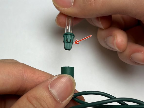

    • Place the bulb into the bulb test socket located on the top side of the repair tool.
    • If the bulb does not light up, get a replacement bulb and move onto the next step.
    • If the new bulb lights up, skip to the final step. If not, move on the next step.

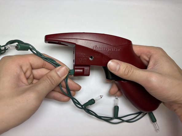

  5. Christmas Lights Not Lighting Up Fix with Lightkeeper Pro: step 5, image 1 of 2 Christmas Lights Not Lighting Up Fix with Lightkeeper Pro: step 5, image 2 of 2
    • Insert the empty socket into the socket connector of the repair tool.
    • Make sure the socket is securely connected.

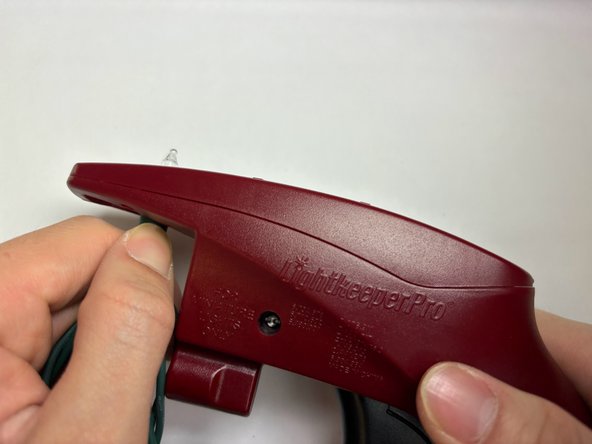

  6. Christmas Lights Not Lighting Up Fix with Lightkeeper Pro: step 6, image 1 of 2 Christmas Lights Not Lighting Up Fix with Lightkeeper Pro: step 6, image 2 of 2
    • Click the trigger on the repair tool 20 times rapidly.
    • If your lights do not turn on, skip to the final step.

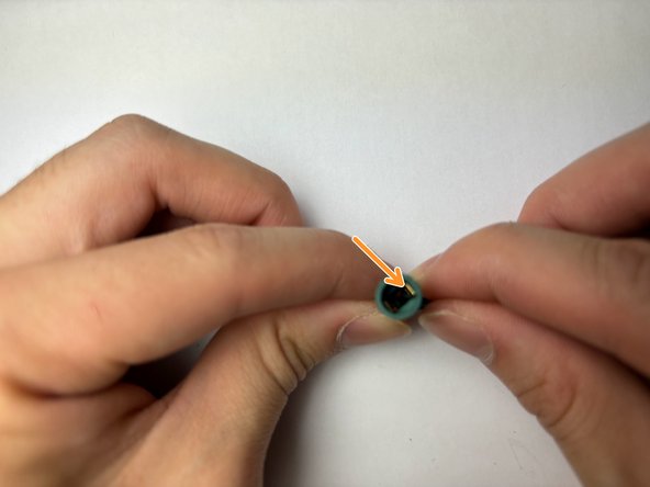

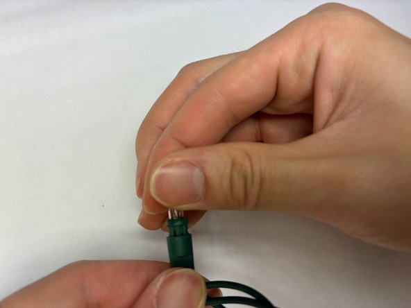

    • Before reinserting the bulb, check the socket and the bulb to ensure that the copper wire on the bulb is touching the metal on the socket.
    • When the bulb is correctly oriented, gently set it into the socket.
    • Caution: do not touch the metal plates inside the sockets to avoid risk of shock
