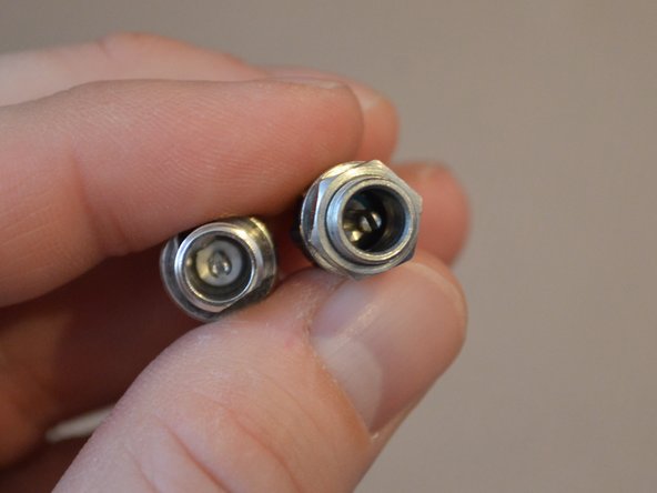

    • Confirm power cable fits properly in new 2.1mm DC power socket and will screw on properly.
    • Other photos shown of factory installed socket, which will not connect properly, and a comparison of the interior of the factory socket (left side) and the replacement socket (right side).
    • The replacement socket and the factory installed socket are the same size (2.1 mm) but may look different in the picture provided.

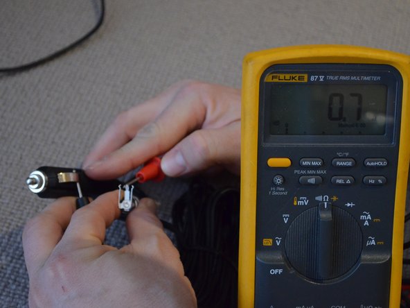

    • The ground pin is far back in the socket so it is easier to perform this task with the cable plugged into the socket. With the power cable inserted and tightly secured, locate and confirm with a meter which terminal on the back is the center pin and which is the outer ground pin.
    • This step is important! The center pin of the socket will connect to the red wire (positive 12 VDC) while the black wire (negative or ground) will connect to the outer pin. The same is true for the power plug - the center conductor is +12 VDC (red) and the outer conductor is Ground (black).
    • An open circuit (no continuity) is demonstrated by the OL notation on this digital multimeter.

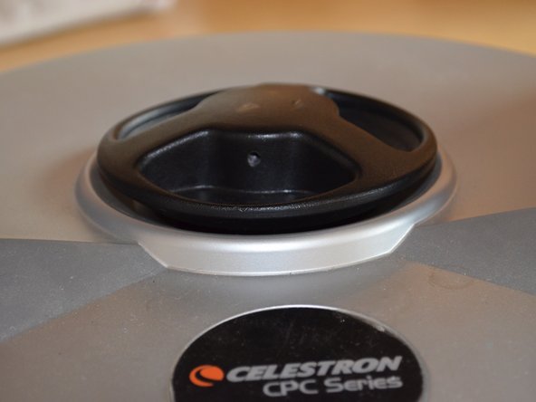

    • Make a note or take a picture of the knob's placement and distance above the base plate before removal. Also pay close attention to the number of rotations to remove the knob completely.
    • Locate the 2mm allen screw and remove completely. The locking knob should unscrew and be removed.

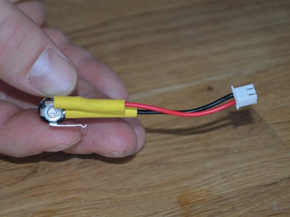

    • Note the location of the red and black wires on the factory installed DC power socket and then cut the wires close to the terminal points.
    • Strip the wire ends to an appropriate length to solder to the replacement socket. Ensure you know the location of the red and black wires on the new socket before soldering.
  7. Celestron CPC 800 DC Power Socket Replacement, Soldering Replacement Part on Factory Cable: step 7, image 1 of 3 Celestron CPC 800 DC Power Socket Replacement, Soldering Replacement Part on Factory Cable: step 7, image 2 of 3 Celestron CPC 800 DC Power Socket Replacement, Soldering Replacement Part on Factory Cable: step 7, image 3 of 3

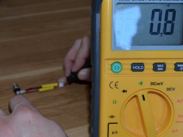

    • Place heat shrink or rubber tubing on wires before soldering then wrap the wire around the terminal for proper soldering.
    • Next, check to ensure you have continuity from the connector to the terminals. It is also good practice to check and make sure you do not have unwanted continuity between the other terminals.
    • Slide heat shrink or rubber tubing over solder points and heat or add electrical tape to ensure isolation.

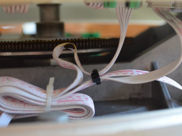

    • Holding the back side of the replacement socket so that the terminals do not interfere with the moving parts, cables, or circuit boards, loosely tighten the nut to hold the socket in place.
    • Next, insert the wire connector in the same orientation as when it was removed.
    • This is a good opportunity to relocate or tie wrap loose cables that may be too close to the gears inside the telescope.
