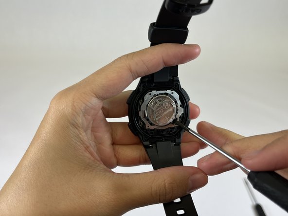

    5. Casio W-753 Battery Replacement: step 5, image 1 of 3 Casio W-753 Battery Replacement: step 5, image 2 of 3 Casio W-753 Battery Replacement: step 5, image 3 of 3
      • Wedge the screwdriver between the battery and the body of the watch.
      Ask FixBot
    6. Casio W-753 Battery Replacement: step 6, image 1 of 3 Casio W-753 Battery Replacement: step 6, image 2 of 3 Casio W-753 Battery Replacement: step 6, image 3 of 3
      • Push down on the screwdriver to lift up the battery and the metal frame.
      • Be sure not to damage the metal frame as that could impact the function of the watch.

    10. Casio W-753 Battery Replacement: step 10, image 1 of 2 Casio W-753 Battery Replacement: step 10, image 2 of 2
      • Place the sticker over the frame into its original position.
      Ask FixBot
