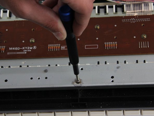

  4. Casio CZ-1000 Piano Key Replacement, Piano Key: step 4, image 1 of 2 Casio CZ-1000 Piano Key Replacement, Piano Key: step 4, image 2 of 2
    • Remove the four 7.5 mm screws using a Phillips #1 screwdriver.
    • Lift the rectangular circuit board away to expose the underside of the key bed.
