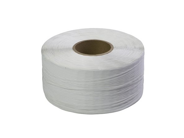

      • The Carrelito is the newest innovation from Lacito! (Photo 1)
      • The Carrelito is a tool used for strapping coils without a plastic spool, only with a cardboard tube on the inner flange of the coil. (Photo 2)

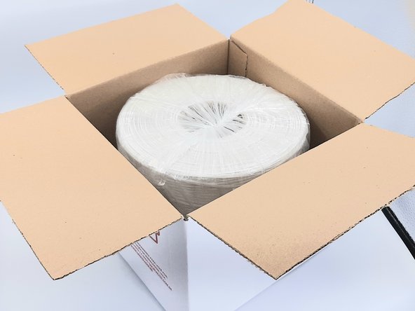

      • The first step to using the carrelito is to take a box of lacito products without a spool! (Photo 1)
      • Once that is done, open the box of headless ribbon spools! (Photo 2)

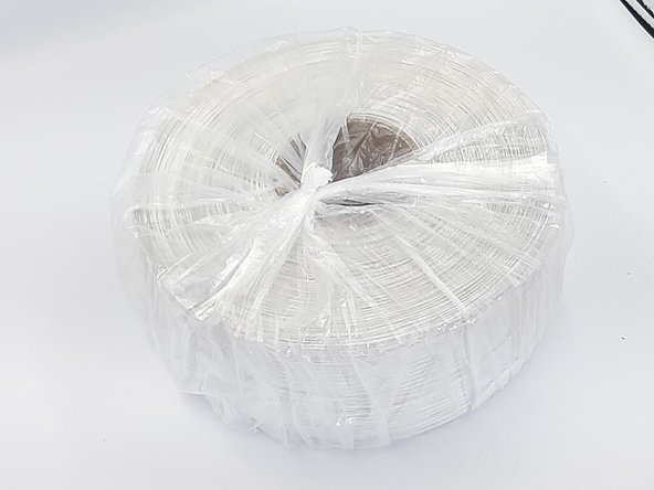

      • Then take a spool and remove it from the box! (Photo 3)

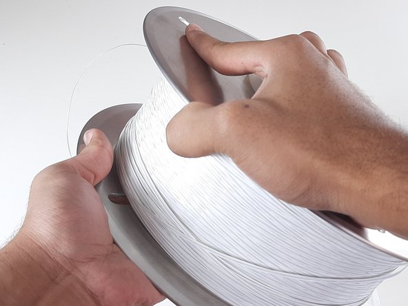

      • Screw the spindle in until you feel that the spool is completely secured!
      • I recommend holding the spindle with both hands and tightening it firmly, until the spool is completely immobile! (Photo 1)
      • If the operator is unsure whether the spool is fixed, they can perform a test to check.
      • To test, simply hold the spindle with one hand and force the spool with the other; if the operator feels it move, tighten the spindle a little more, until the spool is fixed! (Photo 2)
