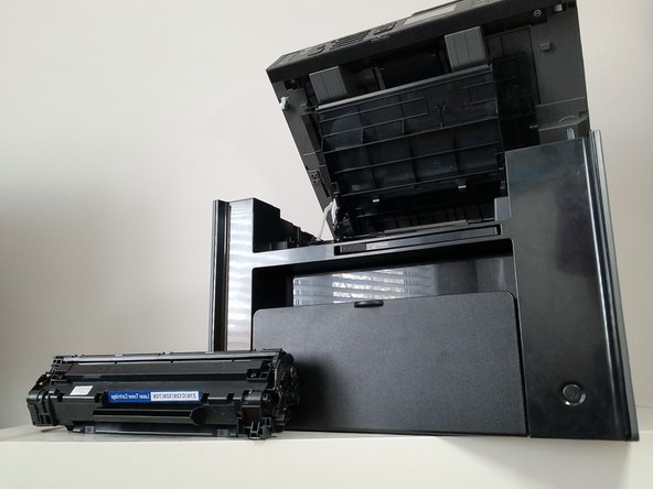

  3. Canon MF4700n Laser Toner Cartridge Replacement: step 3, image 1 of 3 Canon MF4700n Laser Toner Cartridge Replacement: step 3, image 2 of 3 Canon MF4700n Laser Toner Cartridge Replacement: step 3, image 3 of 3
    • Open the toner cover to reveal the toner cartridge.

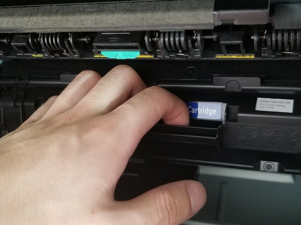

  4. Canon MF4700n Laser Toner Cartridge Replacement: step 4, image 1 of 3 Canon MF4700n Laser Toner Cartridge Replacement: step 4, image 2 of 3 Canon MF4700n Laser Toner Cartridge Replacement: step 4, image 3 of 3
    • Grab the ledge of the cartridge and pull it out.
  5. Canon MF4700n Laser Toner Cartridge Replacement: step 5, image 1 of 2 Canon MF4700n Laser Toner Cartridge Replacement: step 5, image 2 of 2
    • Grab a new/working toner cartridge.
    • If the cartridge is new, then there will be plastic components on it. Follow the manual that comes with the new cartridge to remove the plastic components.
    • Shake the cartridge to distribute the toner evenly inside.

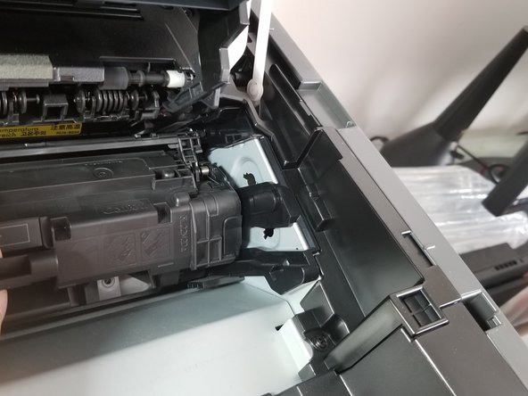

  6. Canon MF4700n Laser Toner Cartridge Replacement: step 6, image 1 of 3 Canon MF4700n Laser Toner Cartridge Replacement: step 6, image 2 of 3 Canon MF4700n Laser Toner Cartridge Replacement: step 6, image 3 of 3
    • On both sides of the cartridge, there are two knobs sticking out.
    • Inside the toner cover, there are two toner guides, one on each side.
    • Align the knobs with the toner guides and push the cartridge securely all the way in.
