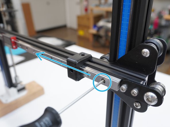

    • Pre-install all the M3x8 SHCS screw and Sliding T-nuts
    • Install the Printed T-nut guide on the end of the X axis extrusion, and slide the rail on to the X-axis from Right to left
    • The guide helps to slide the T-nuts into the extrusion

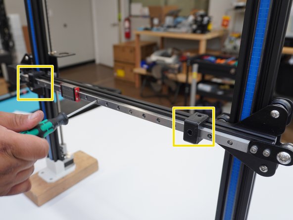

  4. CR-10 V2  Linear Rail Kit Hotend Installation, Mounting the Rail: step 4, image 1 of 3 CR-10 V2  Linear Rail Kit Hotend Installation, Mounting the Rail: step 4, image 2 of 3 CR-10 V2  Linear Rail Kit Hotend Installation, Mounting the Rail: step 4, image 3 of 3
    • Slide the rail until you have about 2-3 mm between the rail and the end of the X axis extrusion.
    • Use both Linear rail Guide to center the rail to the Aluminum extrusion
    • Tighten the mounting screws as you go down. Making sure to slide down, slide the linear rail guide down as each screw is tightened.
