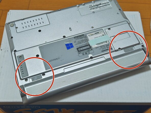

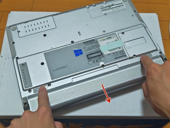

    1. CF-SX2 Memory Replacement and Upgrade, Battery removal: step 1, image 1 of 3 CF-SX2 Memory Replacement and Upgrade, Battery removal: step 1, image 2 of 3 CF-SX2 Memory Replacement and Upgrade, Battery removal: step 1, image 3 of 3
      • There are locks on the left and right sides of the battery.
      • Slide them outward at the same time.
      • While holding them slid outward, push the battery out in the direction of the arrow.
