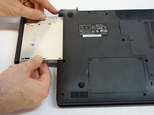

  2. CD / DVD RW drive by why! Replace W253EU, CD / DVD RW drive: step 2, image 1 of 2 CD / DVD RW drive by why! Replace W253EU, CD / DVD RW drive: step 2, image 2 of 2
    • Use a Phillips # 1 screwdriver to screw that holds the CD / DVD drive in place.
  3. CD / DVD RW drive by why! Replace W253EU: step 3, image 1 of 3 CD / DVD RW drive by why! Replace W253EU: step 3, image 2 of 3 CD / DVD RW drive by why! Replace W253EU: step 3, image 3 of 3
    • Pull the CD / DVD drive carefully out
For reassembly, follow the instructions in reverse order.
