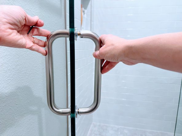

    • Locate the socket head cap screw on the bottom arm of one door handle.
    • Only one handle will have the cap screws—one on the top and one on the bottom arm.
    • Insert the Allen wrench into the cap screw hole.
    • Rotate the Allen wrench counterclockwise to loosen the screw.

    • Once the screw has been loosened, gently pull the handle away from the door.
  3. C-shaped Shower Door Handle Replacement: step 3, image 1 of 1
    • Repeat steps 1 and 2 for the top of the handle.
    • Carefully remove the handle.
