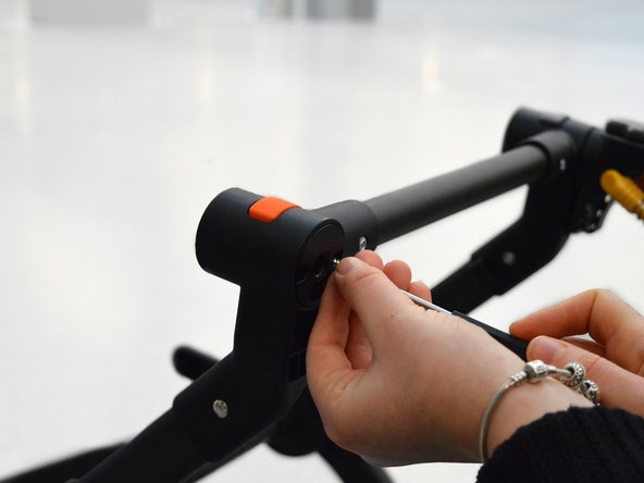

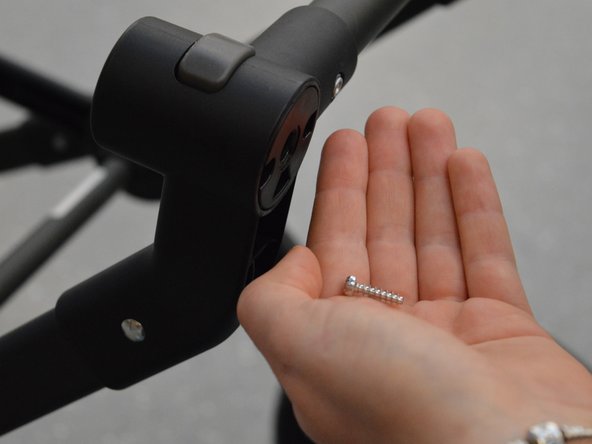

  4. Bugaboo Cameleon 1 and 3 Swivel Wheel Lock Replacement, Remove screws: step 4, image 1 of 3 Bugaboo Cameleon 1 and 3 Swivel Wheel Lock Replacement, Remove screws: step 4, image 2 of 3 Bugaboo Cameleon 1 and 3 Swivel Wheel Lock Replacement, Remove screws: step 4, image 3 of 3
    • Remove the two screws on the black cylinder on the bottom with the Torx screwdriver.
    • Make sure not to lose the screws, since you need them for the reassembly later.

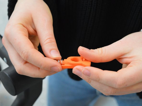

  7. Bugaboo Cameleon 1 and 3 Swivel Wheel Lock Replacement, Attaching the new part: step 7, image 1 of 2 Bugaboo Cameleon 1 and 3 Swivel Wheel Lock Replacement, Attaching the new part: step 7, image 2 of 2
    • Pull the spring from the old part.
    • Attach it to pin on the new swivel wheel lock.

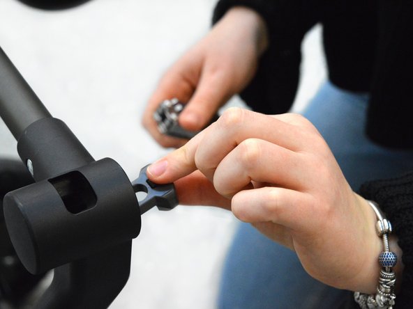

  8. Bugaboo Cameleon 1 and 3 Swivel Wheel Lock Replacement, Placing the new part in the stroller: step 8, image 1 of 1
    • Put the new part with the spring back inside the cylinder, in the orientation shown in the picture.
