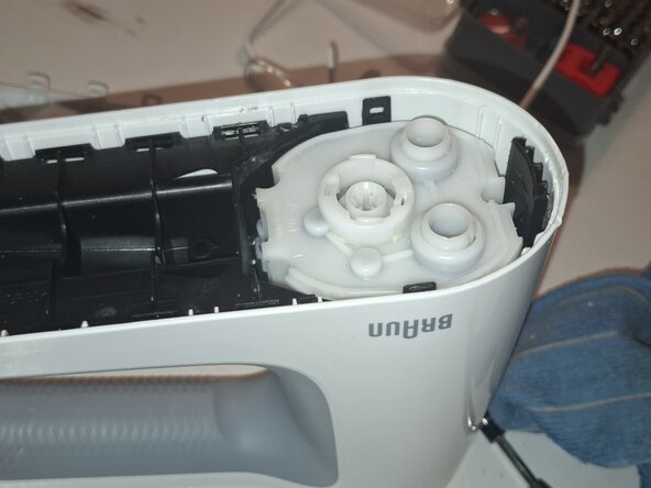

Opening the base plate to remove, for example, dough that has gotten into the mixer.
Tools
    1. Braun Multimix 5 Base Plate Disassembly, Release the small tabs of the bottom plate: step 1, image 1 of 2 Braun Multimix 5 Base Plate Disassembly, Release the small tabs of the bottom plate: step 1, image 2 of 2
      • Release the tabs of the bottom plate all around using a knife or thin tool. It will still be attached at the front at the end.
      Ask FixBot
    2. Braun Multimix 5 Base Plate Disassembly, Release the main tab and remove the bottom plate: step 2, image 1 of 3 Braun Multimix 5 Base Plate Disassembly, Release the main tab and remove the bottom plate: step 2, image 2 of 3 Braun Multimix 5 Base Plate Disassembly, Release the main tab and remove the bottom plate: step 2, image 3 of 3
      • Use a small flathead screwdriver to insert between the white tab on the bottom plate and the black part with the barb, and release the barb.
      Ask FixBot
The base plate can simply be clicked back into place to reassemble your device.
