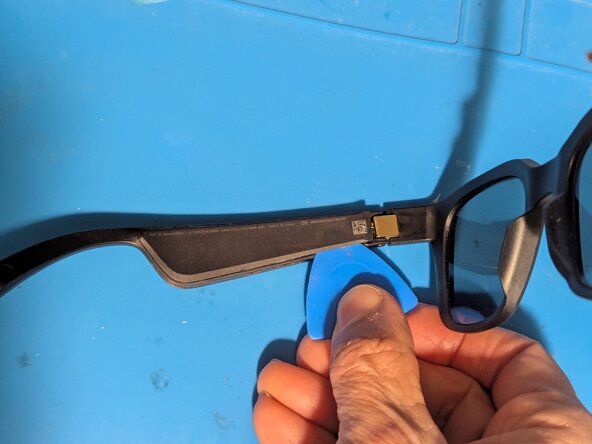

  3. Bose Frames Alto Battery Removal: step 3, image 1 of 3 Bose Frames Alto Battery Removal: step 3, image 2 of 3 Bose Frames Alto Battery Removal: step 3, image 3 of 3
    • Insert an opening pick next to the hinge.
    • Slice the adhesive along the edge of the cover.
    • There is an internal protrusion at this point that will stop your pick.
    • Repeat for the opposite side.

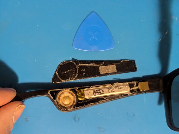

  4. Bose Frames Alto Battery Removal: step 4, image 1 of 2 Bose Frames Alto Battery Removal: step 4, image 2 of 2
    • Remove the cover.
    • Clean the old adhesive from the earpiece and the cover.

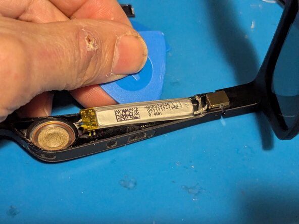

  5. Bose Frames Alto Battery Removal, Remove the Battery: step 5, image 1 of 2 Bose Frames Alto Battery Removal, Remove the Battery: step 5, image 2 of 2
    • The battery is lightly adhered to the earpiece with double sided tape on the end next to the hinge. Pry it up with an opening pick.
    • Turn the battery over and fold it out of the way.
  6. Bose Frames Alto Battery Removal: step 6, image 1 of 1
    • Note the positions of the wires in case your replacement battery doesn't use the same colors.
    • Yellow is the battery positive terminal (+)
    • White goes to the BMS board
    • Red is the speaker positive wire (+)
    • Black is the speaker negative wire (-)
    • Blue is battery negative (-)
