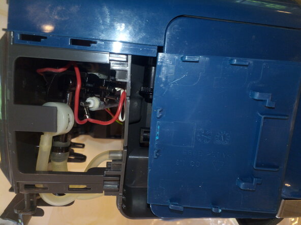

    2. Bosch CTPM Tassimo fix pump error, Open the housing (side panels): step 2, image 1 of 2 Bosch CTPM Tassimo fix pump error, Open the housing (side panels): step 2, image 2 of 2
      • There are small recesses at the markings that indicate where to insert the screwdriver. If you look at the side panels from above, you can see how they are attached.
      • The two clips must be pushed aside while simultaneously sliding the side panel backwards.

      • Cut the cable ties and remove the hose. Insert a toothpick into the outlet of the pump from below – this will release the check ball. This was stuck or blocked by limescale and prevented the water from flowing.
      • If you want to check whether the heating element is so calcified that water can no longer flow through it, this hose must also be opened – as must the hose on the other side of the heating element.
