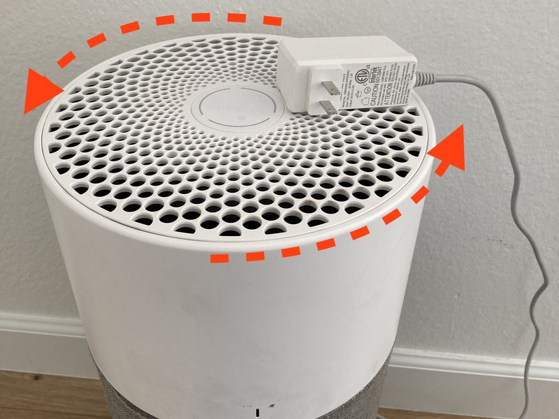

  1. Blueair 311 Auto: Disassembly and disconnection of ionizer, Remove the top fan housing from the base: step 1, image 1 of 1
    • Unplug the power adapter of the air filter
    • Grab the top (white) housing, rotate it counter-clockwise, and lift it to detach it from the base.
