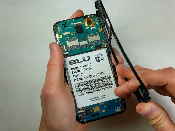

    4. Blu Dash 5.0 Dual SIM Back Camera Replacement: step 4, image 1 of 3 Blu Dash 5.0 Dual SIM Back Camera Replacement: step 4, image 2 of 3 Blu Dash 5.0 Dual SIM Back Camera Replacement: step 4, image 3 of 3
      • Peel off the back panel with your hand.
      • Remove the back panel slowly to avoid breaking it.

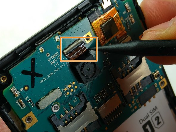

    5. Blu Dash 5.0 Dual SIM Back Camera Replacement: step 5, image 1 of 3 Blu Dash 5.0 Dual SIM Back Camera Replacement: step 5, image 2 of 3 Blu Dash 5.0 Dual SIM Back Camera Replacement: step 5, image 3 of 3
      Tool used on this step:
      Buy
      • Flip up the ZIF flap using the spudger.
      • Gently remove the ribbon cable with tweezers.
      • The ribbon cable is sensitve and needs to be removed carefully to insure its integrity.
      • Remove the back camera using tweezers.
