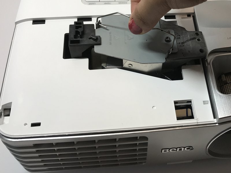

    3. BenQ HT1075 Projector Lamp Replacement: step 3, image 1 of 1
      • Using a Phillips #1 (PH1) screwdriver, loosen and remove the single 2.5 mm Phillips #1 screw that secures the lamp housing to the projector.
      Ask FixBot
    4. BenQ HT1075 Projector Lamp Replacement: step 4, image 1 of 1
      • Remove the lamp from the projector by pulling on the lamp handle.
      • Apply more force on the side opposite of the newly removed screw as you pull the lamp out.
