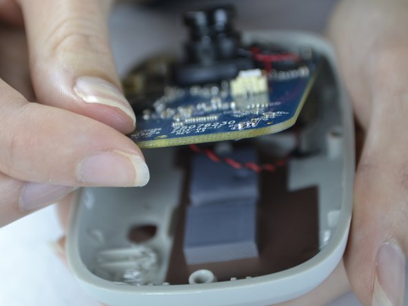

    2. Belkin NetCam HD Lens Piece  Replacement: step 6, image 1 of 3 Belkin NetCam HD Lens Piece  Replacement: step 6, image 2 of 3 Belkin NetCam HD Lens Piece  Replacement: step 6, image 3 of 3
      • With your fingers, pull the circuit board out of the back casing.
      • When pulling the board up be sure to do so carefully so you do not break the cord which is attached on the back side.

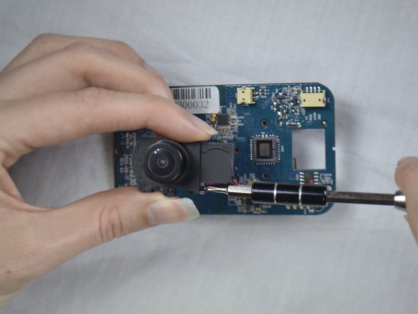

    1. Belkin NetCam HD Lens Piece  Replacement, Lens Piece: step 9, image 1 of 2 Belkin NetCam HD Lens Piece  Replacement, Lens Piece: step 9, image 2 of 2
      • Flip the circuit board to the back side.
      • Fold down the tape with your finger.
      • With the Phillips #0 screwdriver, unscrew the two 1.2 mm screws.
      Ask FixBot
    2. Belkin NetCam HD Lens Piece  Replacement: step 10, image 1 of 2 Belkin NetCam HD Lens Piece  Replacement: step 10, image 2 of 2
      • Flip the circuit board back to the other side.
      • Unscrew the screw with a Phillips #0 screw driver.
      Ask FixBot
    3. Belkin NetCam HD Lens Piece  Replacement: step 11, image 1 of 1
      • Slide the attached piece from the lens holder device.
      Ask FixBot

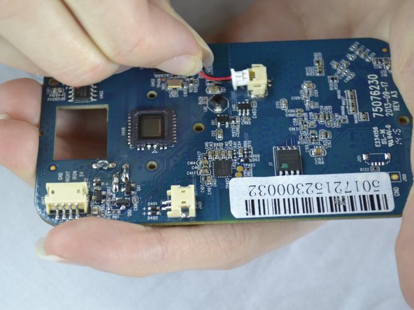

    4. Belkin NetCam HD Lens Piece  Replacement: step 12, image 1 of 2 Belkin NetCam HD Lens Piece  Replacement: step 12, image 2 of 2
      Tool used on this step:
      Buy
      • Use the tweezers to pull the white attachment out from the port a little.
      • Then, take your fingers and gently pull the white attachment out from the tan port.
