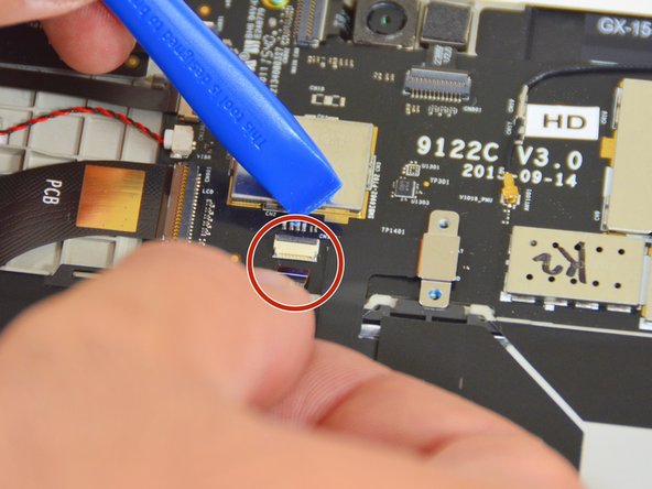

    2. Battery replacement on the Why! Tablet: step 4, image 1 of 3 Battery replacement on the Why! Tablet: step 4, image 2 of 3 Battery replacement on the Why! Tablet: step 4, image 3 of 3
      • Remove the screw near the corner of the battery.
      • Using the opening tool, disconnect the connector located near the edge of the motherboard, next to the camera module.
      • Disconnect the connector on the left edge of the motherboard.

    3. Battery replacement on the Why! Tablet: step 5, image 1 of 3 Battery replacement on the Why! Tablet: step 5, image 2 of 3 Battery replacement on the Why! Tablet: step 5, image 3 of 3
      • Disconnect the small white connector in the center of the motherboard.
      • Disconnect the connector on the left edge, near the battery label.
      • Disconnect the battery connector, in the upper right corner of the motherboard.

    4. Battery replacement on the Why! Tablet: step 6, image 1 of 3 Battery replacement on the Why! Tablet: step 6, image 2 of 3 Battery replacement on the Why! Tablet: step 6, image 3 of 3
      • Caution: Handle the battery with care. Avoid bending, puncturing, or damaging it.
      • Disconnect the last connector on the edge of the motherboard.
      • Gently lift the battery to free it from its recess, then remove it from the tablet.
