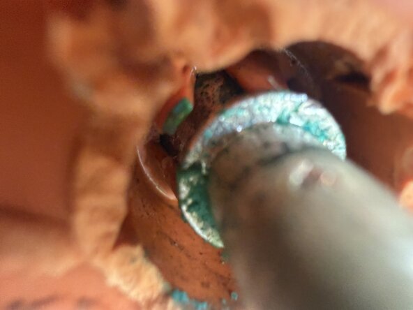

    6. Battery Terminal Replacement: step 6, image 1 of 1
      • Inspect and clean the terminal post.
      Ask FixBot
