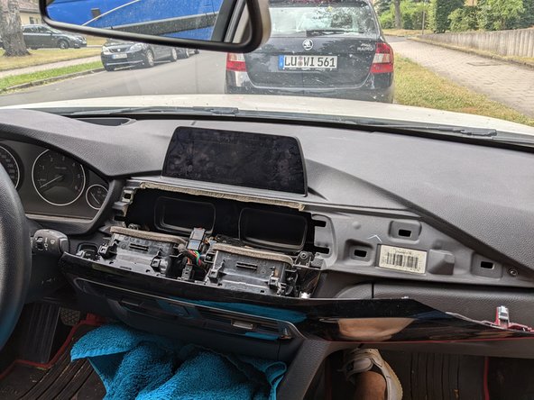

    1. BMW F31 2015 Display Replacement, Display: step 1, image 1 of 1
      • First, the entire trim panel beneath the display must be released.
      • No tool is needed for this; simply pull on the decorative trim with constant force, as it is only clipped into place.
      • The decorative trim must be released all the way to the right to the passenger seat and can then simply hang down by its cables.
      Ask FixBot
    2. BMW F31 2015 Display Replacement: step 2, image 1 of 1
      • Then, release the two T20 Torx screws and unplug the display upwards.
      • Be careful; the display is still attached by a connector that must be released from the back.
      Ask FixBot
Follow the steps in reverse order to reassemble your device.
