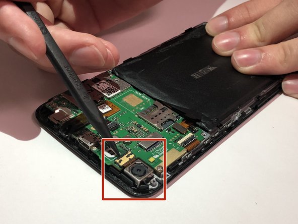

  5. BLU WIN HD LTE Camera Replacement, Camera: step 5, image 1 of 3 BLU WIN HD LTE Camera Replacement, Camera: step 5, image 2 of 3 BLU WIN HD LTE Camera Replacement, Camera: step 5, image 3 of 3
    • Pry off the low profile connector located on the right side of the camera device.
  6. BLU WIN HD LTE Camera Replacement: step 6, image 1 of 1
    • Pull the camera out.
