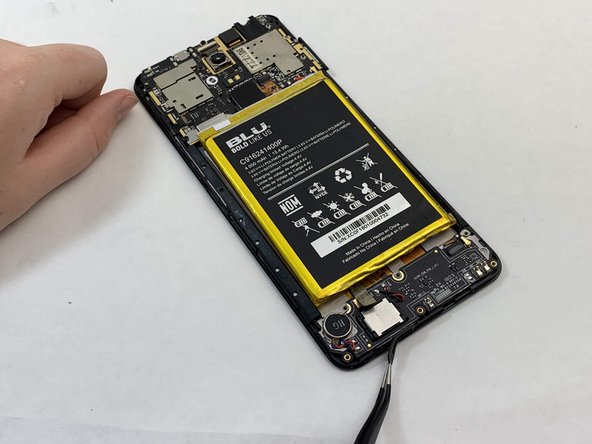

    • Use the tweezers to remove metallic tape on the metal speaker housing.
    • Set tape aside so it can be reattached later.

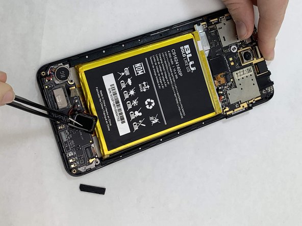

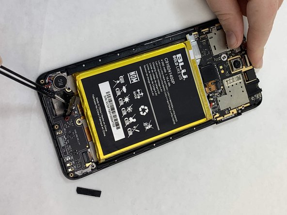

    • Remove the rubber protective covering from the side of the speaker using the tweezers.

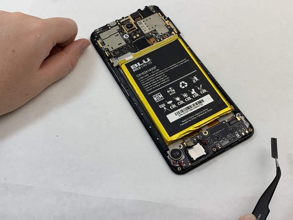

    • Use the tweezers to remove the metal speaker housing from the phone. Set aside for later.
    • Wedge the tweezers in bottom right hand corner of the speaker and pry it up to remove it from the adhesive.

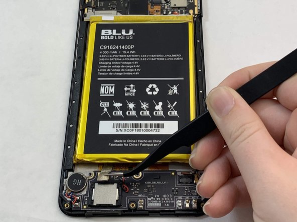

    • De-solder the wires from the bottom sub-frame and the speaker. Use the link listed to safely de-solder the speaker.
