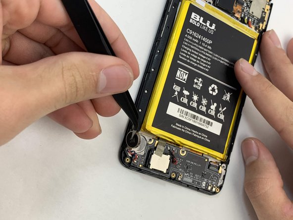

    • Using either an opening pick or a pair of needle nosed tweezers, gently pry and lift the microphone away from the sub frame.
    • It has an adhesive coating applied to the back of it so there may be significant resistance.
  8. BLU Vivo One Plus Microphone Replacement: step 8, image 1 of 2 BLU Vivo One Plus Microphone Replacement: step 8, image 2 of 2
    • Once removed from the sub frame the microphone can be desoldered and the replacement part can be used. Click here to see how to solder.
