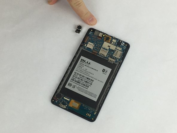

    4. BLU Life XL Rear Camera Replacement: step 4, image 1 of 2 BLU Life XL Rear Camera Replacement: step 4, image 2 of 2
      • Use the plastic prying tool to gently push the rear camera out from its socket.
      • Take the camera out and set it aside.
      Ask FixBot
    5. BLU Life XL Rear Camera Replacement: step 5, image 1 of 2 BLU Life XL Rear Camera Replacement: step 5, image 2 of 2
      • Carefully place the new camera in the camera socket.
      • Apply a little force on the top of the camera to slide it in the socket.
      • Pop the camera in the socket and make sure its stable.
