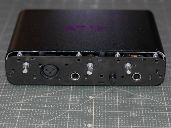

    5. Avid Fast Track Solo Disassembly, Unscrew screws: step 5, image 1 of 2 Avid Fast Track Solo Disassembly, Unscrew screws: step 5, image 2 of 2
      • Unscrew all the screws fitted on the front plate, in the following order:
      • Use a PH1 screwdriver to remove the two PH1 screws securing the XLR jack.
      • Use a PH2 screwdriver to remove the remaining PH2 screws securing the front metal plate to the chassis.
      • The Direct Monitor button hat (between the two 6.3 mm jacks) can be left as is throughout the whole disassembly, alternatively it can be remove by gently pulling it straight out.

    6. Avid Fast Track Solo Disassembly, Remove the front plate: step 6, image 1 of 3 Avid Fast Track Solo Disassembly, Remove the front plate: step 6, image 2 of 3 Avid Fast Track Solo Disassembly, Remove the front plate: step 6, image 3 of 3
      • The front plate should sit loose on the body without any screws holding it.
      • Remove the front metal plate.
      • One may slide an iFixit pick in the seam between the front metal plate and the metal chassis if the plate does not fall off and all screws are loosened.
      Ask FixBot
