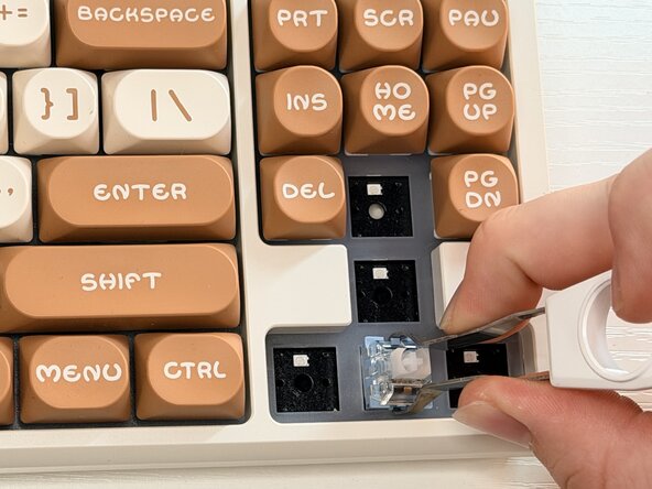

    4. Attack Shark K86 Key Switching Replacement Guide: step 4, image 1 of 3 Attack Shark K86 Key Switching Replacement Guide: step 4, image 2 of 3 Attack Shark K86 Key Switching Replacement Guide: step 4, image 3 of 3
      • Use your switch puller and place the hooks under the plastic clips on both the top and bottom of the switch.
      • Hold the keyboard steady with one hand, with the other hand, squeeze the puller firmly and pull the switch straight upward until it pops free from the hot-swap socket.
      • Avoid twisting or pulling too hard, which can damage the board's sockets.
