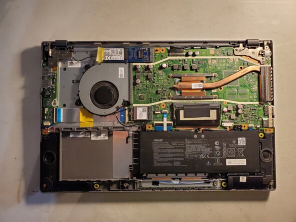

    3. Asus X515 SSD Replacement, Disconnect battery: step 3, image 1 of 3 Asus X515 SSD Replacement, Disconnect battery: step 3, image 2 of 3 Asus X515 SSD Replacement, Disconnect battery: step 3, image 3 of 3
      • Locate the battery and its connector.
      • Using your fingers or a prying tool pull up on the connector to disconnect it.
      Ask FixBot

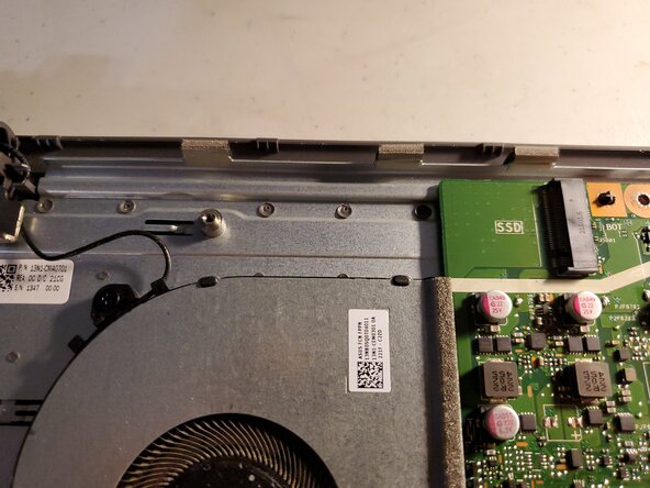

    4. Asus X515 SSD Replacement, Remove the SSD: step 4, image 1 of 3 Asus X515 SSD Replacement, Remove the SSD: step 4, image 2 of 3 Asus X515 SSD Replacement, Remove the SSD: step 4, image 3 of 3
      • Locate the SSD
      • Peel the tape so that you can access the screw.
      • Remove the single screw.
      • The SSD will pop up and face outwards.
      • Pull the SSD outwards.
