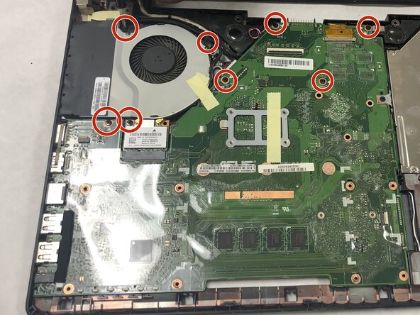

    1. Asus R510CA-OB01 Fan  Replacement, Motherboard: step 14, image 1 of 1
      • Remove the eight 5mm screws that are holding both the fan and motherboard in place using a Phillips #1 bit.
      Ask FixBot
