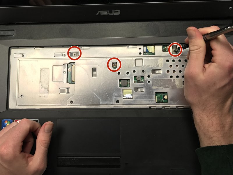

    1. Asus G73JH-RBBX05 Fan Replacement, Fan: step 3, image 1 of 1
      • Remove the 4mm screws located under the keyboard with the PH0 screwdriver.
      Ask FixBot

Some steps missing, regarding screws to remove: 1 screw that holds optical drive; once that is removed, 2 screws in the drive compartment; 2 screws in the battery compartment; 3 screws from the bottom of the motherboard.
