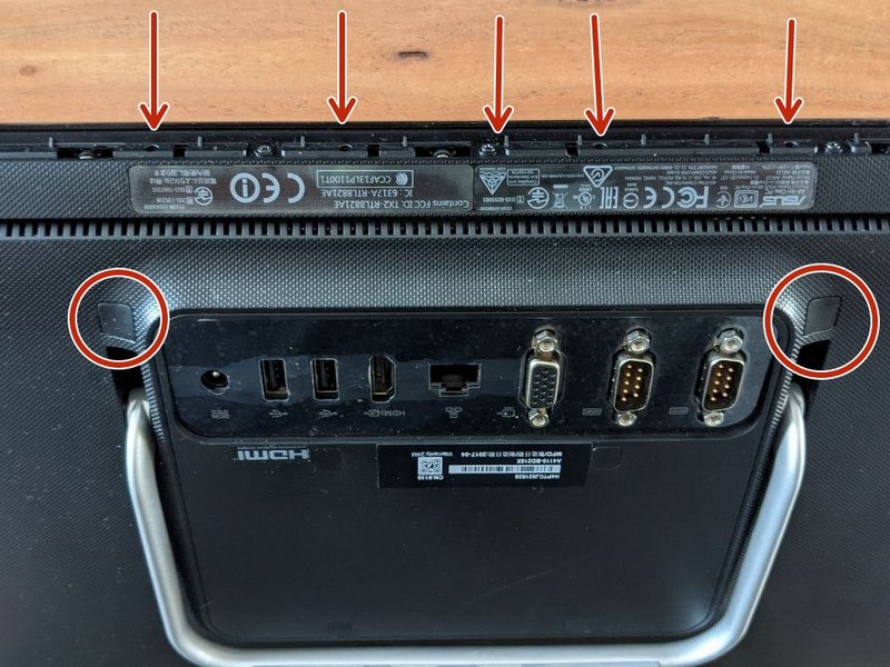

    1. Asus A4110 Disassembly, Open case: step 1, image 1 of 2 Asus A4110 Disassembly, Open case: step 1, image 2 of 2
      • Remove screws at the circles
      • Remove gum strap and screw 5 screws out
      • Use a big screwdriver or some plastic to softly open the entire case around, starting at one down corner where your removed the screws before. The plastic clips will click a little. Don't be to hard.
      • Then you can lay the back next to the front, see second picture.
