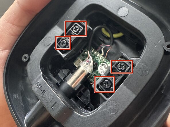

    2. Astro A10 Gen2 Tighten Microphone: step 5, image 1 of 2 Astro A10 Gen2 Tighten Microphone: step 5, image 2 of 2
      • Remove the four 7mm screws with a Phillips #1 screwdriver.
      • You may want to use a 60mm screwdriver extension to reach the screws inside of the headset.
      Ask FixBot

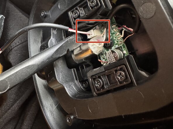

    3. Astro A10 Gen2 Tighten Microphone: step 6, image 1 of 2 Astro A10 Gen2 Tighten Microphone: step 6, image 2 of 2
      • Lift the speaker area.
      • Disconnect the wires that connect the microphone.
      • Remove the 7mm screw with a Phillips #1 screwdriver.
      Ask FixBot

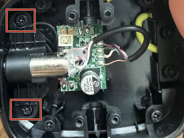

    7. Astro A10 Gen2 Tighten Microphone, Tighten Microphone: step 13, image 1 of 2 Astro A10 Gen2 Tighten Microphone, Tighten Microphone: step 13, image 2 of 2
      • Ensure the microphone is flush against the outside of the housing.
      • Screw the microphone back in using the Phillips screw.
      • My wires were still intact and I still had the screw, so that's all I needed to do. To put everything back together, just go in reverse.
