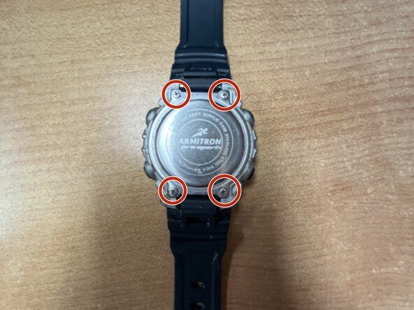

    1. Armitron MD14314 Battery Replacement, Remove Screws Holding Caseback on: step 1, image 1 of 1
      • Remove the 4 PH00 Screws

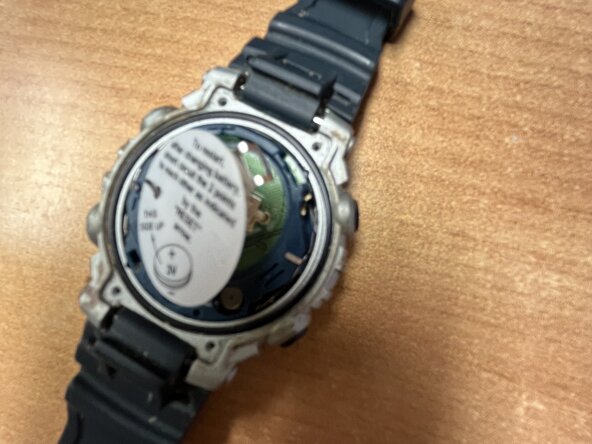

    2. Armitron MD14314 Battery Replacement, Remove bracket holding battery down: step 2, image 1 of 1
      • Using Tweezers carefully lift up the bracket holding the battery in place
      Ask FixBot
    3. Armitron MD14314 Battery Replacement, Remove and replace the battery: step 3, image 1 of 1
      • Replace the CR2025 battery
