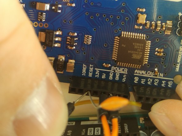

    9. Arduino Leonardo Bootloader Replacement: step 9, image 1 of 2 Arduino Leonardo Bootloader Replacement: step 9, image 2 of 2
      • Now take the capacitor and plug one end into the GND pin and one end into the RESET pin.
      • Take the wire plugged into pin 10 on the Uno and link it to the RESET pin on the Leonardo
